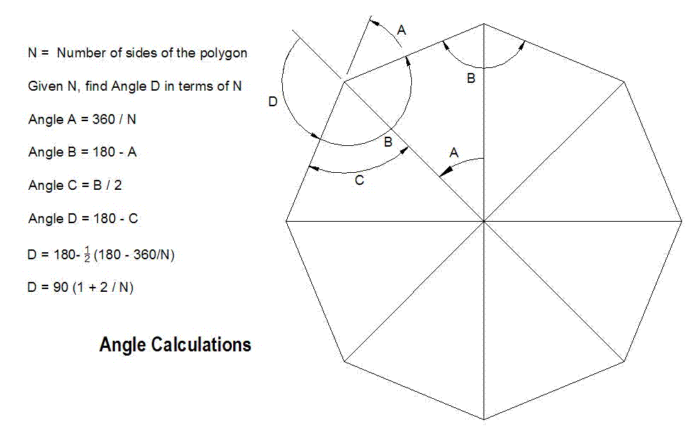

Geometry question. If N is the number of sides of a polygon, can angle D be expressed in terms of N? See attached figure.

Thank you Mick. I'm sure that will come in handy in these MTs somewhere.
