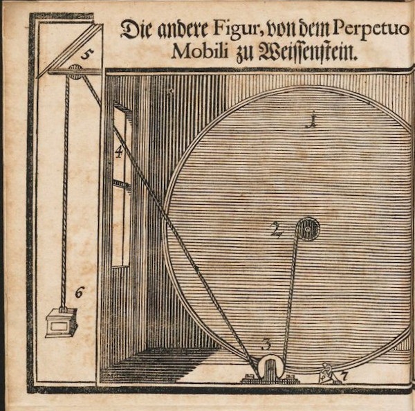

Notice the floor pulley is larger than the roof one.

. If the first pulley (the one attached to the load) is smaller in diameter and the second pulley (the one attached to the roof) is larger, the system will behave as follows:
The load pulley in the pic is the roof pulley. Is the MA is going to increase or decrease if the diameters are switched ( larger on floor and smaller on roof)? Better radio the copilot, we might have some turbulence ahead.

So in the pic the driving pulley/axle is 8” diameter. The driven pulley is maybe 1/2 to 2/3 that; 4-6”.
The ma for that is 1/ [1/2] to 1/[2/3].
2 to 1.5 ish MA.

Ecc1: The load pulley in the pic is the roof pulley. Is the MA is going to increase or decrease if the diameters are switched ( larger on floor and smaller on roof)? Better radio the copilot, we might have some turbulence ahead.
That's correct. Copilot didn't know the setup. I gave it the wrong setup before I just looked at the picture.
Copilot: This setup could potentially provide a mechanical disadvantage, making it harder to lift the load. However, the exact setup of the pulley system would determine its effectiveness and sensitivity to movement
But they are different sizes which does affect the mechanical advantage.

Sam you beat me to it. If the rope at the axle moves up 6 inch's the box outside the window would move 6 inch's.
The only advantage I see is the wheel is attached to the floor so for stability it makes sense to pull up. If you look at the pulley's they end up with the rope on half their circumference this means better grip so less slippage and heat.

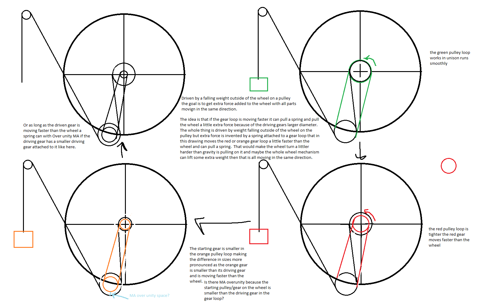

A short description here for this is that if a loop grinds into itself it can instead pull a spring on a gear that would pull the wheel mechanism a little harder if all of the items are moving in the same direction. Can doing this create Over Unity because of manipulating the gear sizes at the pulleys? The driving force is pulling a weight down by a pulley outside of the wheel mechanism but the over unity device would be the gears attached to the pulleys grinding into each other with various gear levers and speeds. I concluded that it might be possible in my drawing here that if the gear driving gear loop the grinds back into the wheel mechanism has a small gear attached to its larger pulley oriented gear that as long as the final driven gear in the center of the mechanism indicated by colors in this drawing is moving faster than the wheel that that spring could be turned with over unity MA.
