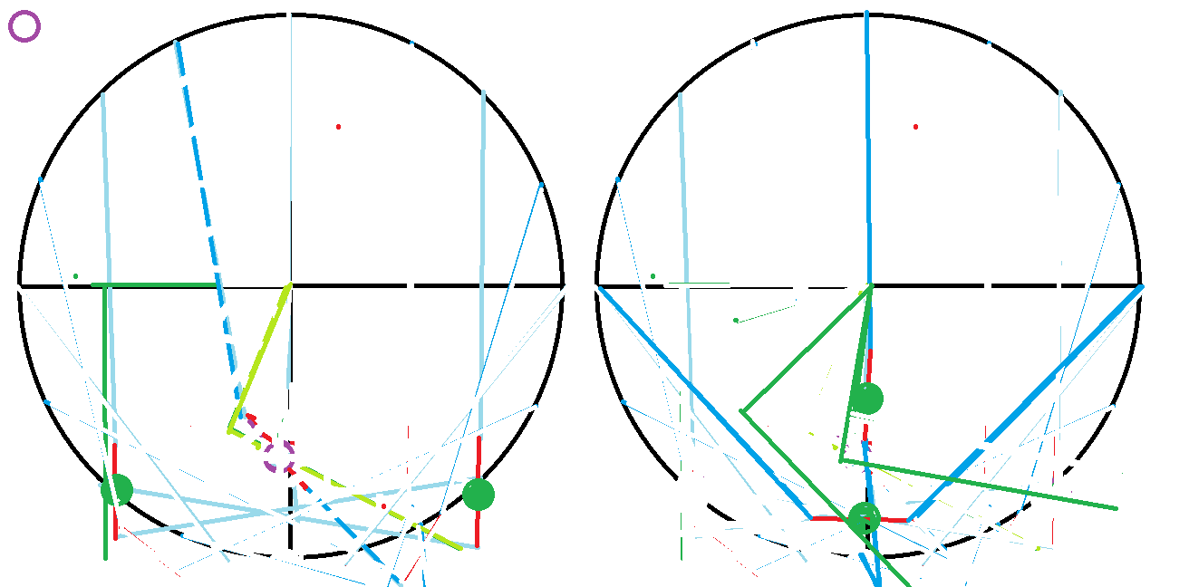

So I take it that in the simulation that the L shaped lever is not part of the wheel but a pendulum that pushes the weight out of place. Focusing on this aspect of it, if you put the strings at an angle to the bar that holds the weight, it will try to hang the weight to one side, and when it does this it can go up on the lever losing MA and this could allow the pendulum to push the weight to the side some more. The trade in forces in this version would be the L shaped levers length against the weight. If the weight on the red bar can push the L shaped lever into place then the L shaped lever closely mechanically to it would lose being held there when the weight on the bar rises some along its lever. I don't know what the difference of this would be to just blocking the weight with a peg or a bar or ramp to move it to the side. I guess it would be better like this than a ramp because the hanging weight would be moving up and away from the L shaped lever and a ramp would have the weight moving up against it. SO the L shaped lever in this drawing would work like a moving ramp and while the weight is lifting it is suspending on this L shaped ramp some rather than moving up it.

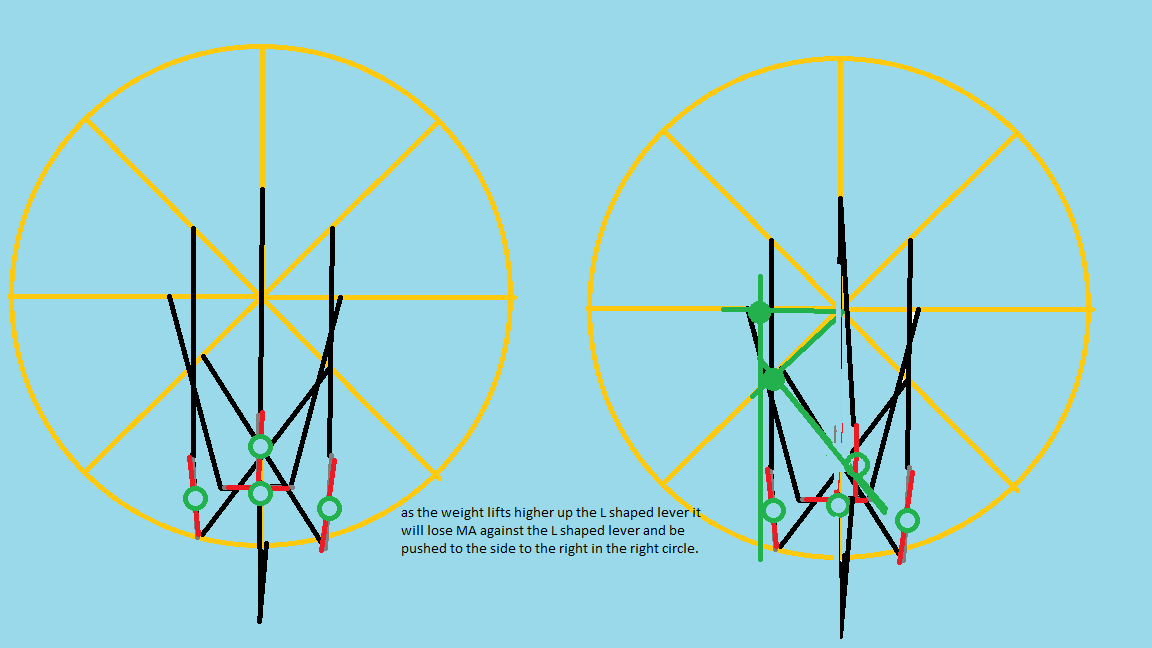

- Posts: 1954
Here is another MS paint sketch. Bodabing. It looks like the L shaped lever would be smacked from a weight falling downward when the L shaped lever is pushed to the left. I think it's heavier, the weight force, when the weight is suspended on two strings and when it is on one string it doesn't have as much weight downwards. Is it true?
Hi preoccupied, I sometimes look at ideas like the one you are showing but I think it would be better for you if you experimented with Algodoo. If nothing else its easier to do good drawings of your ideas but of course you can also do fairly good simulations too.

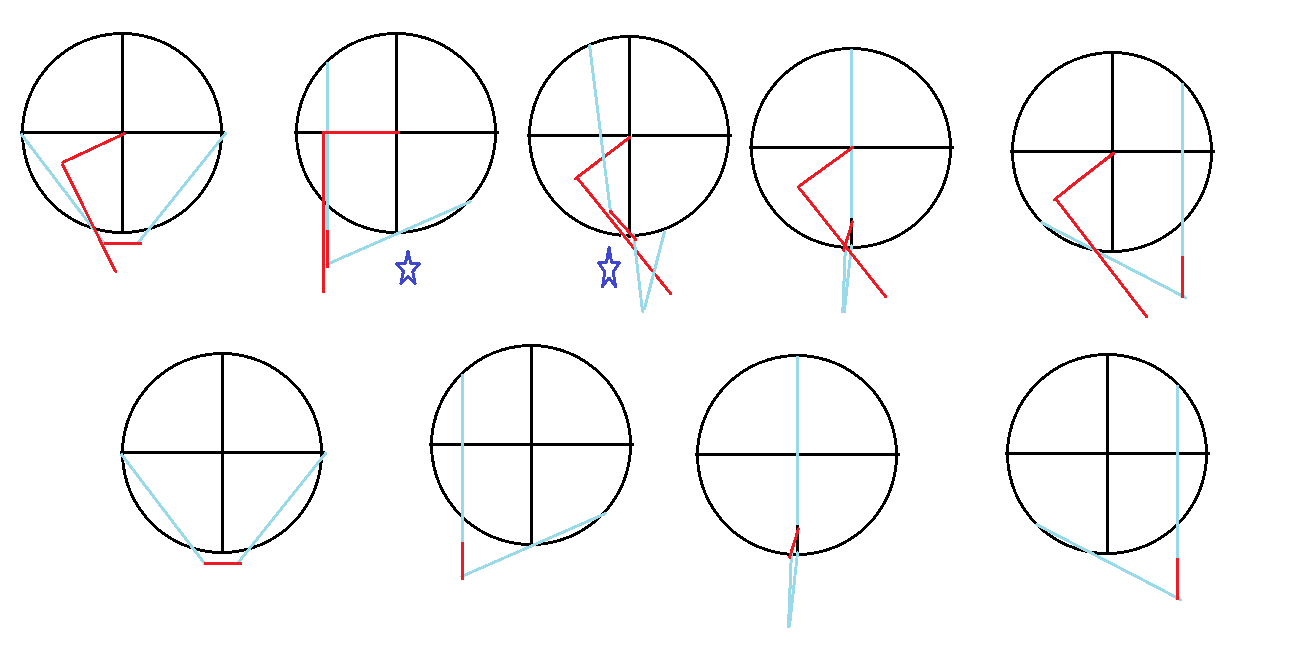

- Posts: 1954
I made one more ms Paint drawing. In the starred figures does it give a 45 degrees of positive torque there? Then it can have 8 wheels like it working together to have 360 degrees of positive torque. It's supposed to push the L shaped lever up to where it is hanging straight down and then be pulled straight up and away and also to the right by the L shaped lever. It's being lifted against a wedge up top on its connection and up a ramp from the L shaped lever and this should reduce its weight. Good work Fletcher. Very interesting.
