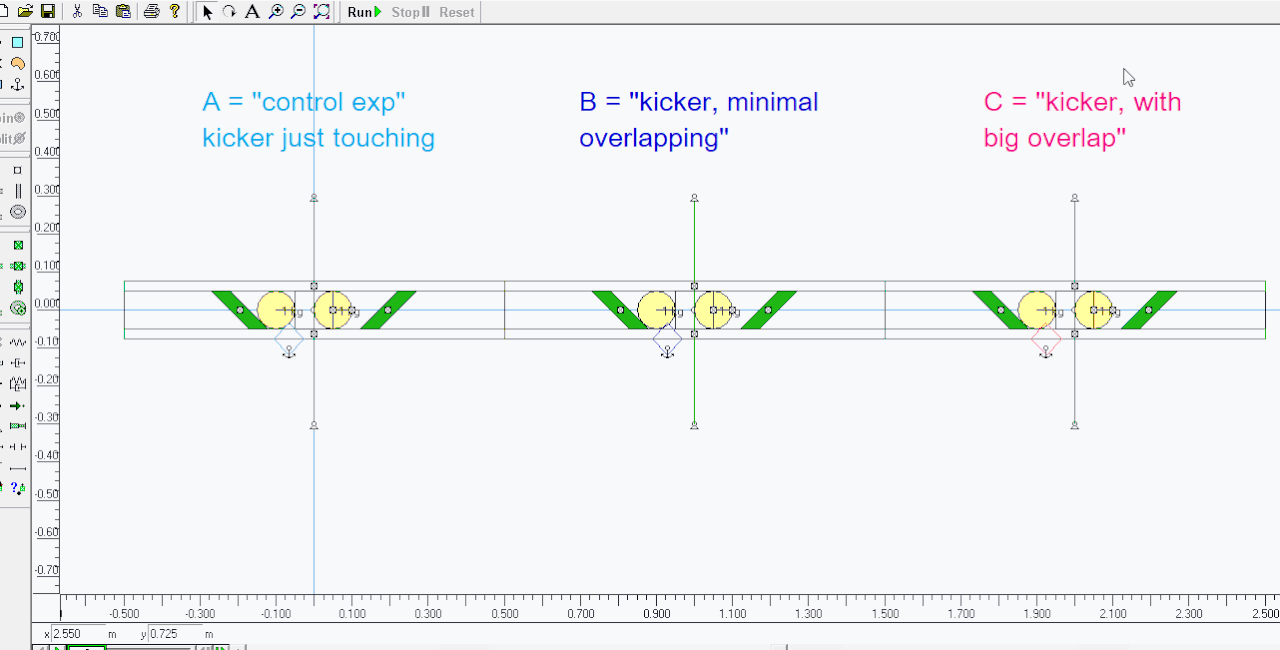

Hi Rox .. I had a quickish scan of your thread today to get the gist of what you have been proposing ..
I did a quick simplification of what I think your Law of Levers workaround appears to me to be .. i.e. that the intervention of an anchored object induces extra energy into rotation ? ..
So I made a quick simplification sim ..
Assumptions are that a pendulum structure starting from horizontal should swing higher than horizontal if it has extra KE - all yellow masses are 1 kg each ..
I have made 3 side-by-side pendulums as can be seen - the first to the left has an anchored "kicker" only just touching the yellow weight - the second it overlaps somewhat - the third it overlaps quiet a lot ( if you zoom in ) ..
I have added Vectors>Contact forces ( red ) to see the various contact positions ( the lhs yellow weight is contained in a "cage" etc ) - also blue velocity vectors .. sim attached ..
Summary :
The greater the overlap of the background anchored "kicker" intervention the greater is the pendulum velocity and KE ..
Conclusion :
1. This appears to be an artifact of WM2D overlap error when two objects are placed too close together ( overlapping ) before a simulation is run ! - the sim attempts to "spit the objects apart" introducing fictitious energy into the system/sim ..
2. Adjust the placement of the 'kicker' to test the hypothesis/theory i.e stress test the sim ..
3. Build a real-world pendulum test with 'kicker' intervention and compare to sims ..
Best -f
Summary :
Conclusion :
Best -f

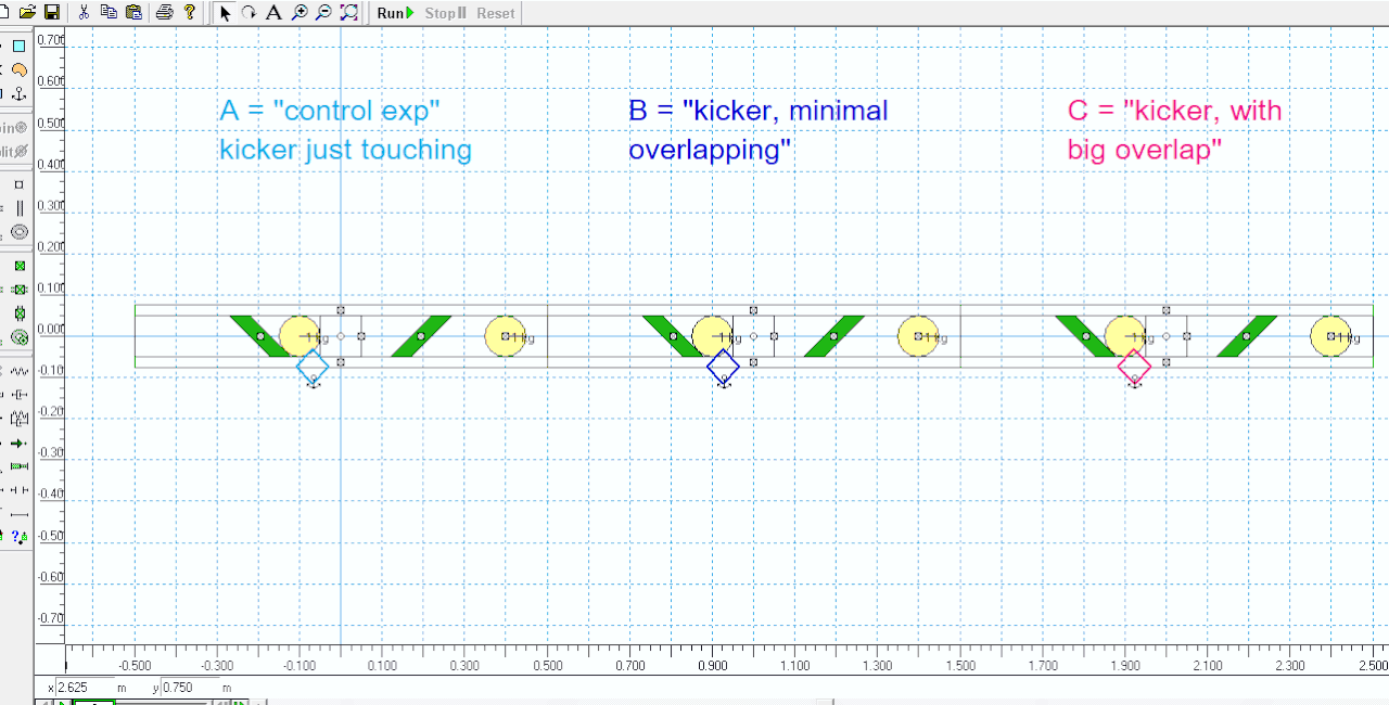

Hi Rox .. I modified my previous sim to more closely represent what you just showed in Algodoo - now the rhs weight is half the distance to pivot than the lhs ( see animation of sim ) ..Graham wrote:Run the simulation then release the fixate on the left so the lever can move.
You will see that the lever still moves upwards.
Exactly the same thing happens in WM2D when you do the equivalent of this.
What I think is happening here is a kind of chicken and the egg situation and it doesn’t break any laws.
Initially when the lever is released the right hand weight overbalances the left one because the left hand weight is partly resting on the fixed ramp. So the lever moves clockwise but the moment it does so it then feels the overbalance due to the left hand weight being further from the axle. However because of inertia it cannot stop instantly and rises just a little before coming back down.
This is what I hope is happening but as I say the only way forward is a real experiment.
This is what I think is happening ..
Note that when resting on the fixed ramp ( "kicker" ) that the lhs yellow weight shows red dots as contact points and forces - the contact force of a circle is at right angles to the circumference - this means when resting on the ramp the ramp pushes back with the same force ( Newton's Laws ) - in effect some of the weight is being offset by the ramp push back ( see the lhs sim ) n.b. resultant forces are x and y vectors - in the case of the other 2 sims left to right the ramp overlap gets worse progressively - this time they physically eject the lever CW against its natural tendency to rotate CCW - this is not "Physics" but the program trying to maintain integrity i.e. when objects interact by collision or resting against each other there is deformation losses and small change in shape at contact point - the programs cannot process this fine detail frame to frame as the real-world does - so there is an attempt to separate them and in the process they are spit apart with energy/velocity ..
** The trick is to design a sim experiment, whether in Algodoo or WM2D, to separate Newton's Laws from programing artifacts such as overlap error which is well known about .. **
If you look at the animations and run my sims you can see the contact forces ( and fixed ramp sharing the load ) and see when the overlap error is at work for each of the 3 side-by-side sim experiments ..
As you say the best simulator is a real-world experiment, which we all agree on - I can easily see a fixed ramp absorbing/countering part of the lhs weight ( balancing forces ) but I can not imagine it reacting like an overlap error would in the real-world ..
Look forward to your real experiments tho ..

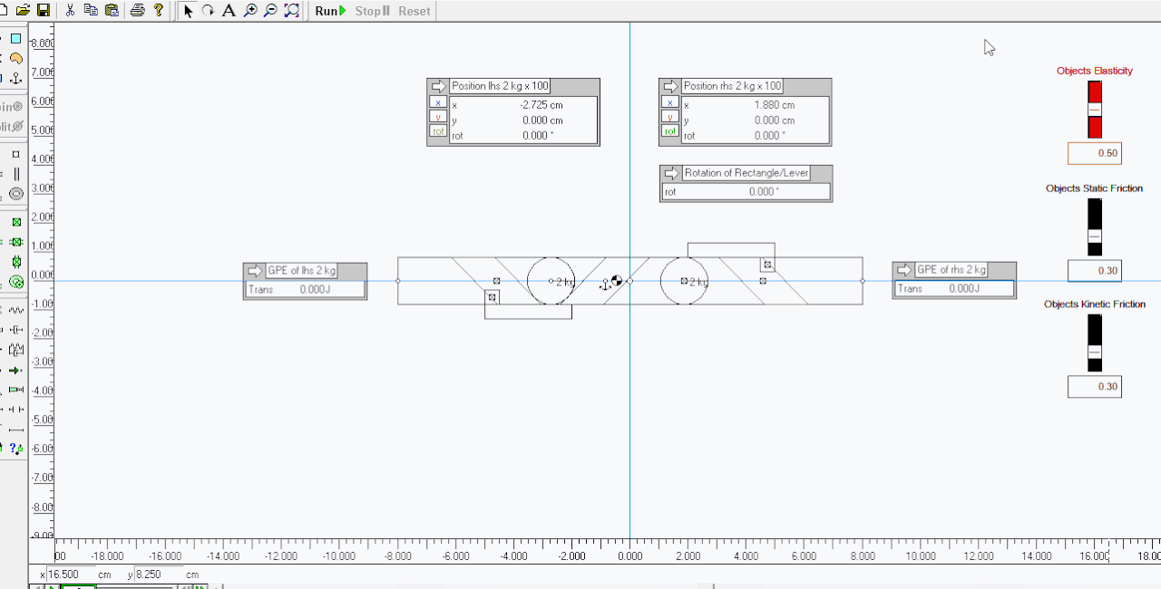

Hi Graham .. that's the thing mate - the weight on the lhs does not rise up - it loses some GPE as can be seen by the metering/outputs ..
The rhs weight at the shorter arm also loses some GPE as can be seen in the outputs and visually .. this is because while the rhs weight is fixed/pinned to the horizontal lever the lhs weight is not and is free to make contact and "settle" - which is does - zoom in and see the overlaps as it settles - note the system COM icon also drops a little when the sim is run ..
N.B. I rebuilt parts of your sim because something wasn't right with the green guides COM - also I added positional output metering etc and inputs for Elasticity etc .. but mostly to get everything to have zero Gravitational Potential Energy ( GPE ) at the start - n.b. when an anchor is used it removes the object anchored from the system COM/CoG calculation and icon which shows it ..
Sim attached ..
- B. work out 1156 Lever(2)-1.wm2d
- (23.08 KiB) Downloaded 22 times

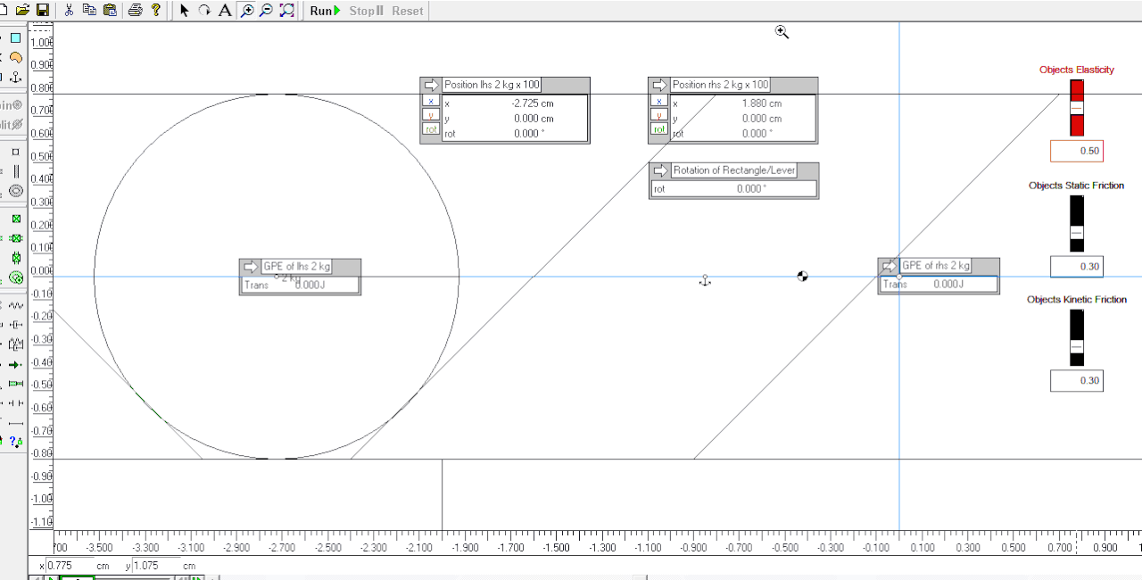

Hi Fletcher the thing is that if the objects overlap in that way then yes the weight is going to drop too far so doesn't your accuracy settings sort that out?
Here are some close up screen shots of my simulation followed by a screen shot of yours.
The first shows the simulation before it is run showing the small gap at the bottom of the left hand weight which is the reason why it works in the first place.
The second is after it has been run and you will see there is no overlap like there is on yours.
The third is showing my accuracy settings.
The forth is a screen shot of your simulation in comparison showing the overlap.
