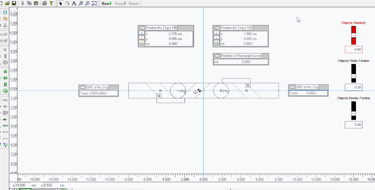

Graham .. I think jb did a pretty good job of giving a blow by blow description of what was happening in my sim replication ( thx jb ) - fwiw the accuracy I set it to was 2,000 fps with an integration error of 0.035 cm - all objects involved in the pivoted lever arrangement were pre-set to the zero horizontal x-axis ( i.e. had zero y-axis height at start ) - then as jb said, on running the sim the lhs weight falls a little ( loses GPE ) until it makes firm contact with the guides etc - the integration setting determines how deep each will penetrate the other - when at full allowable penetration depth the red contact forces will stop showing 'bouncing/flickering ( determined by elasticity setting )' and thereafter be constant/full - this means the lever itself will slightly rotate CW from temporary imbalance and its fixed rhs weight lose some GPE as noted ..
** Note that the original sim you supplied is a very small scale - the lever being only 16 cm long by 1.6 cm high - that's why I chose to use a higher accuracy setting than I usually use with larger models ( proportionality ) - also I use SI units so that rotations are in degrees etc ..
Ok, here is the sim reworked for your bottom support clearance note Graham - to do that I had to lift the lhs weight above the zero line so that it had a starting height of 0.005 cm ( had some GPE ) - and I reduced the integrator error down from 0.035 cm to 0.01 cm ..
Here is my generic suggestions on WM sims for investigating OU/PM mechanics ..
1. Always measure the System NET GPE at start for a gravity only system - after running the sim look for a System NET GPE increase or decrease ? - usually there will always be a Net decrease which also usually translates to an equivalent gain in System KE ( with no frictions etc ) i.e. the zero sum game we talk about so much ..
2. If there is a System NET increase in GPE AND/OR System KE then take a closer look at the accuracy and integrator error setting ( always use accurate Kutta-Merson setting ) - increase the accuracy and decrease the integrator error allowances to "stress test" the sim across a range of settings to see if the effect is lasting and robust ..
3. IF there is a System NET GAIN in GPE / or NET KE then examine the sim for objects being placed too closely together i.e. beyond integrator error/tolerances because for the sim to maintain integrity from one frame to the next it will "spit-out" the objects to allowable/acceptable tolerances - this will automatically inject either/or a System NET increase in GPE and/or KE - which is entirely an artifact of the coding and programing of the kinematic sim leading to errant and false results i.e. not a good and reliable approximation of expected real-world behaviour and results .. the deeper the penetration the more violent the expulsion and KE GAIN ( that was why I showed in 1 sim 3 side-by-side setups with greater and greater fixed guide overlap i.e.1. to graphically show how violent the reaction could be and how it could lead to fictitious gains in System GPE and KE i.e.2. rotate a horizontal lever to vertical/top heavy etc ) ..

Hi Fletcher thanks for taking the time to do that.
There are some things that look similar to mine and I will have to take a closer look at it tomorrow and I will probably end up doing some working out myself but I will have to do it my own way.
