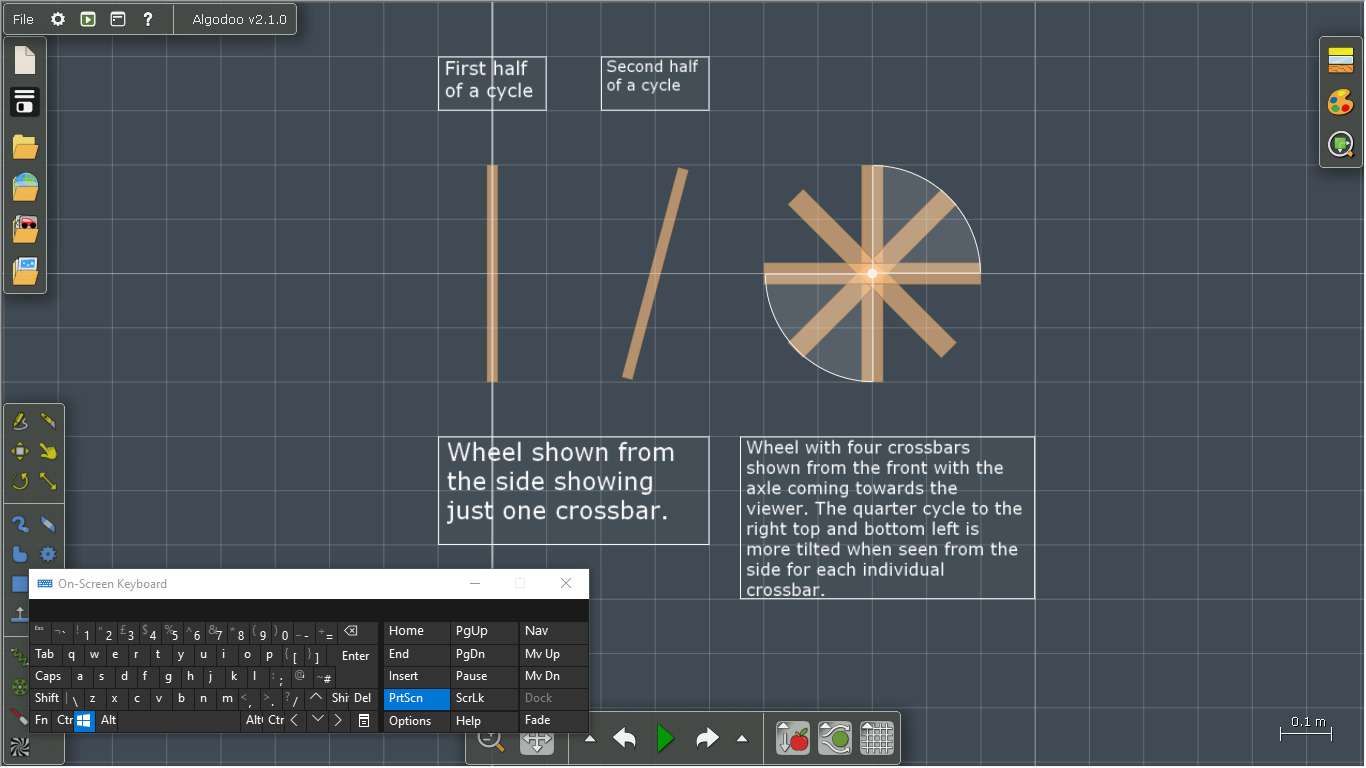

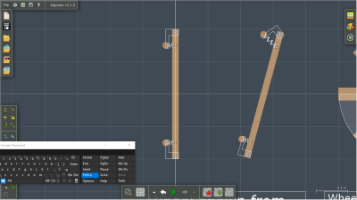

Test sous Algodoo aves jouets forgerons
Test under Algodoo with toy blacksmiths
- Fletcher test.zip
- (455.29 KiB) Downloaded 37 times

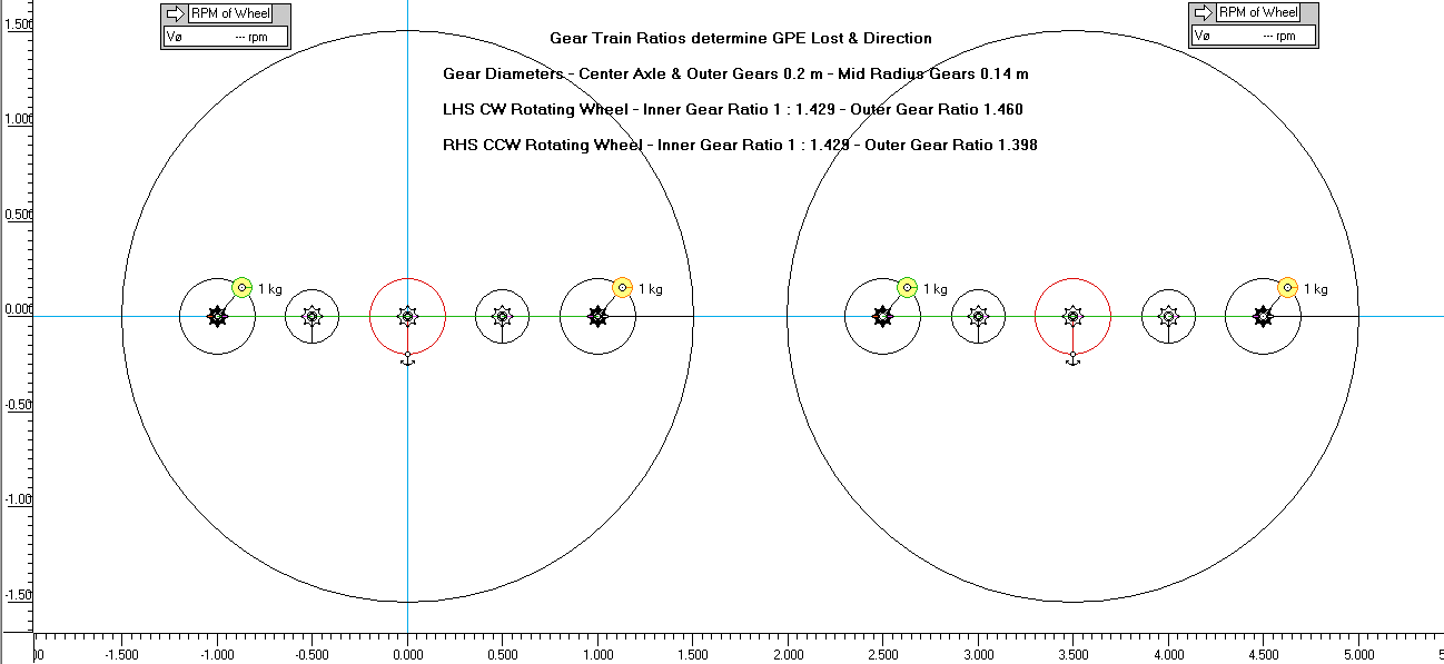

SHADOW wrote:
Hi Fletcher, I did this test under Algodoo and the whole remained in balance, did you put the friction?
Hi Shadow .. (thx jb) .. my sims have the appearance of geared Roberval Balances (i.e. Ramelli Balances which predate Roberval's) - but it is just an illusion - there are no frictions but they would make no differences to performance at moderate levels ..jb wrote:Fletchers perfect example , should still rotate in the face of friction imo , because the weights and gears should "unwind" via gravity , in fact i believe Fletcher could replace the weights with springs and it should still work but then its not via gravity (not that gravity is a requirement for us anyway) , its still not out of the question that an "unwinding" could have been used , as we well know though it all comes down to whether there is a reset .
The inner and outer gear diameters are 0.2 meters and the mid radius gear diameters are 0.14 m - this gives gear ratio from axle to mid gear of 1 : 1.420 & from mid gear to outer of 1.420 : 1 - at these ratios the wheel could not turn because it could not lose any GPE i.e. there is no torque .. it is a true Ramelli Blance ! ..
In the left hand side wheel (LHS) I changed the outer gear ratio to 1.460 and in the RHS I changed it to 1.398 - now both wheels have the ability to lose GPE each revloution, and thus have torque, which we see as the CCW and CW rotations i.e. they are slowly losing GPE - this means they can turn for a very long time, however the weights will slowly lose height, hence the spiral path they take downwards over time - IOW's they are like a spring wound clock whereby the weights have to be pre-positioned by hand so they have PE to lose (the reset) ..
These sims also show that gravity is conservative - if I was to meter the kinetic energies of each wheel (add up its components KE's) their KE's would not exceed the GPE lost at any time ..
And if we were to have moderate/realistic frictions present then all that would happen is the the KE's acquired + frictional energies dissipated would equal the GPE lost as it spiraled down and lost its GPE ..IOW's their RPM's would be less ..

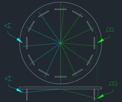

Here is another example , B should technically be nearer than A to the center , but how much would depend on how long the Z guides are , and this would drop the center of mass below the axle too , however it cant return to its former radius on the same side and i don't really like that (well it can but not as designed with a single direction slot here).
ETO , i forgot to mention , if a mass is further along z it would not really want to fall back inwards at around 12 because that would be a lift too , the same for around 6 falling outward(rotating) along z would be a lift.
Last edited by johannesbender on Fri Feb 23, 2024 11:07 am, edited 2 times in total.

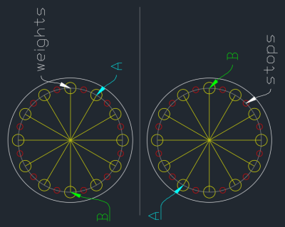

version 1 :
A disc with around 12 levered weights like the top image equally spaced , but there is a stop halway in between each weight , and each weight is held in place by some latch , they are all in balance , then as any lever comes in to around 1 it gets released (lets say on the right side) , and if any released lever reaches 6 it gets caught again , this creates a torque , but the effect breaks after a certain amount on the right has released latches , it would seem going all the way to 6 for a reset wont work like that .
The second version does the same , but releases any weight at around 6:30 7-ish , and catches them at past 12 as they pivot over to reset , but the same result takes place , it would have torque to the right but as soon as a certain amount in total is released its going to produce a counter directional torque that stops it .
I think such a concept like this i mentioned now which is releasing then dropping on to stops and catching has the same problems of a radial change approach , the weight that gets released had to be reset within a limited time such that not to much weights get released at once which would stop the torque , and that would be a required lift.
Further than this i have not thought of any other designs (apart from long ago RB types) , to be fair the answer might still be a radius change or something else, i was just annoyed at it .

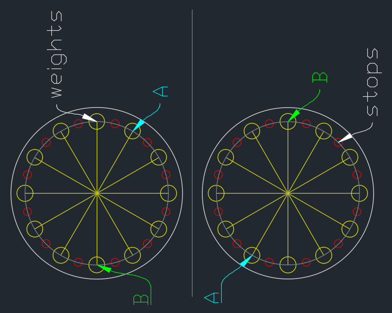

Although i know these were failed ideas , just to be clear and complete the above ↑ by adding the images.johannesbender wrote: ↑Sat Feb 24, 2024 12:22 pm Honestly the non radial type of concepts is an area i did not dive very deep in to , the latest i looked in to was :
version 1 :
Edits : making a bunch of faults texting on my mobile
Weighted levers are latched in balanced positions , released at around A , and re-latched/caught at B .
ETOA , i looked at every weight release , and every 2nd and 3rd...
Last edited by johannesbender on Sat Feb 24, 2024 6:42 pm, edited 2 times in total.
