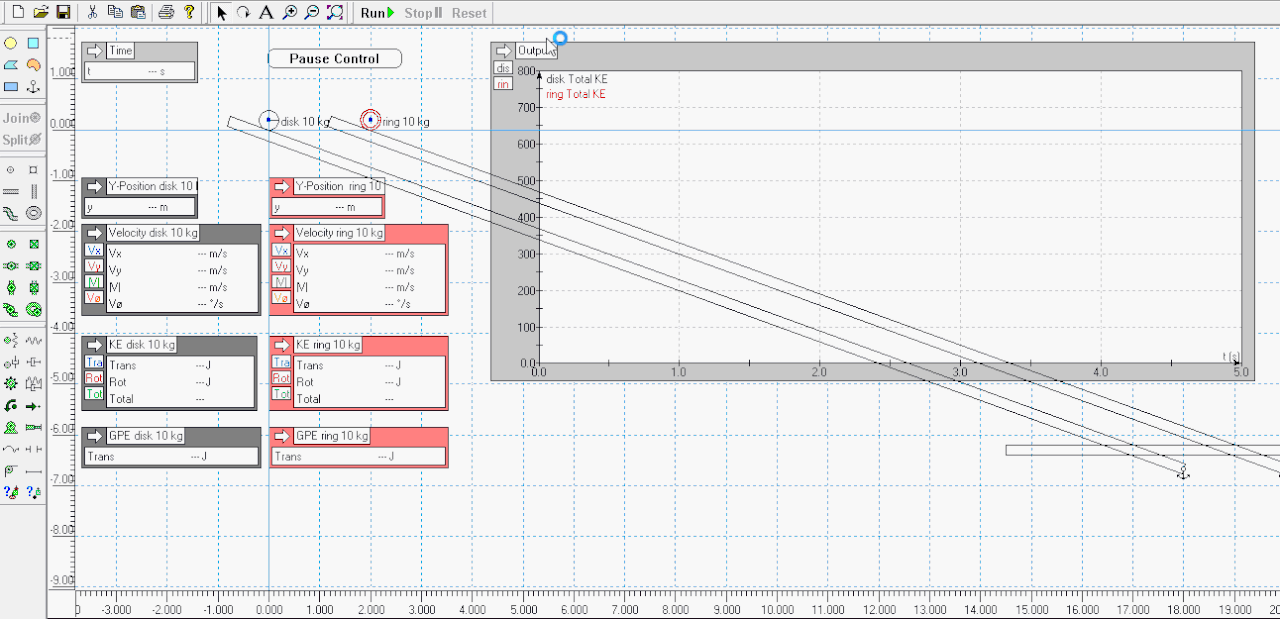

I agree .. here I made a sim of a disk verses a ring ( attached below ) - both have mass of 10 kgs and roll down a slope of 20 degrees losing 6 meters of vertical height .. the sim pauses when each gets to the -6 meters mark .. look at the Outputs for velocity and KE ( RKE and TKE ) for each when paused ..Tarsier79 wrote:Not sure I understand your view on this. You have translational energy, and rotational energy. The hoop has more inertia, because its mass is distributed further from its axis, so it is harder to spin up: therefor harder to slow down as well. Because of this, it is moving slower at the bottom of the ramp.My biggest point is missing though. That is if I stopped the hoop just before impact at the flags at the bottom where is the missing energy? Where is it physically? Energy in a closed system is conserved. There is no "energy well" to put it in under todays physics. It is not all spinning. It is just missing due to V^2 term.
If you rolled all the rollers down a half pipe, in an ideal world, they are all going to roll back up the other side to (nearly) the same height, even though the hoop attains a slower maximum velocity at the bottom compared to the sphere. I don't see any energy lost here.
Total KE is slightly different because of dissipative losses to frictions etc, and skipping and slippage etc - T79's scenario of running them back up the half pipe would see both nearly gain their original heights and GPE ( but not both exactly the same but near enough imo, small percentage difference ) ..
- ring-v-disk1a1.wm2d
- (28.53 KiB) Downloaded 19 times

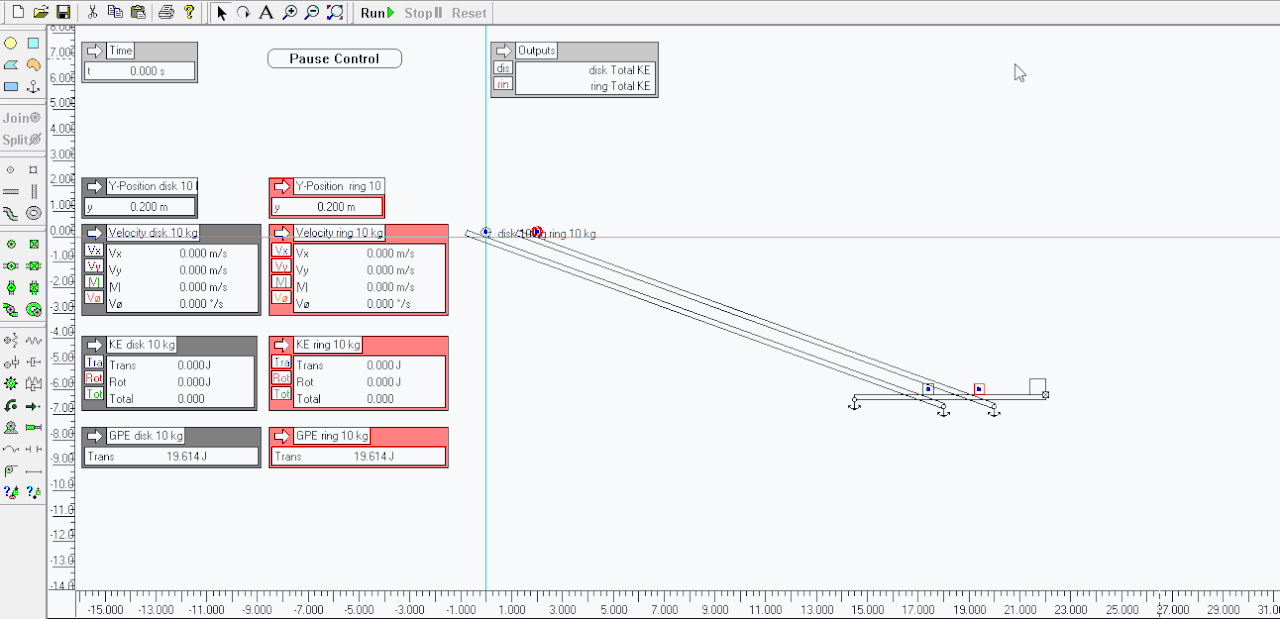

Flags on frictionless slides so they maintain their initial velocities received - both 'flags' weigh 10 kg each - both maintain separation and same velocity after contact indicating the same WD on both and have the same Translation KE .. imo ..daxwc wrote: I don't see any impacts at the flag. I am talking impact energies at the flag differentials.
- ring-v-disk1a2.wm2d
- (30.93 KiB) Downloaded 19 times

The hoop is still rolling on its rim or shell. ROLLING! Not spinning rolling. Therefore it does the same distance down the ramp. So they are going the same distance but one has a formula in point mass that has a more negative energy (backwards distance per average point of mass component) slowing acceleration. So if the ramp gets very long and the rim on the hoop can not spin the more energy discrepancy due to different maximum speeds.
The way I see it anyway. I don't know how to explain it clearer.
Here is Copilots answer it seems to agree:
True. The hoop, while rolling on its rim or shell, covers the same distance down the ramp as any other object. The key difference lies in how the energy is distributed between translational and rotational forms due to its moment of inertia.
When the hoop rolls down the ramp, its kinetic energy is divided into translational kinetic energy (movement along the ramp) and rotational kinetic energy (spinning around its axis). The distribution of mass in the hoop, being further from the axis, means it has a higher moment of inertia. This results in a slower translational speed compared to objects with lower moments of inertia, like a solid ball.
At the bottom of the ramp, the hoop's total kinetic energy is a combination of its translational and rotational energies. When it impacts the flag, the energy involved in the impact will be different from other objects due to the

Re: Hypothesis .. Raising GPE without using Law of Levers ? ..
Thanks Fletcher for all the effort.
I don’t know; doesn’t make sense to me.
Either the SIM is letting it spin up (not rolling on its rim)
Or
The max speed are exactly the same.
Both cant be true and have the same impact energy the longer the ramp gets.

I see it as this dax, fwiw .. the ring and disk have different inertia's - we all agree that the ring has more inertia than the disk because of its mass concentrated at the extremities, so it has greater resistance to being sped up or slowed down than the disk - if there is a set number of atoms for both ( have same mass ) each atom is rotated ( sine wave pattern ) around the objects traveling Center of Rotation ( as it rolls down the slope ) - iow's, the atoms of the ring on average have to move a greater circular distance as the ring rolls than those of the disk - to move a distance takes time, and each atom has the same individual inertia quotient in any direction .. thus altho both ring and disk rotate the same number of times ( ideal situation ) because the ring has the greater moment of inertia it can not have the same straight line velocity as the disk on arrival at its final height - meaning that both the ring and disk have the same Total KE - this is made up of Translational ( straight line ) KE and Rotational ( circular ) KE, but in different proportions because of their different moment of inertia from mass distribution ..
Therefore, when the ring and disk collide with the 'flag' both a portion of momentum and Total KE is transferred to the 'flag' n.b. momentum transfer is not often a complete transfer, especially when masses in collision are different, as can be seen by the original ring and disk continuing forward slowly after collision ..
An impact is a quick/sharp contact i.e. force applied for a short period of time ..
An impulse is a force applied usually over a longer time period compared to an impact ..
The relevance is that the disk gives most of its momentum and energy to the flag in what is more an impact scenario - most of that momentum and energy comes from the translational inertia of the disk as it has a higher velocity and a lesser angular inertia - a small portion comes from the rotating disk "followthru" i.e. it wants to continue rotating forward from ramp frictions and moment of inertia resistance to change in motion .. the ring collides with its flag with more of a prolonged impulse - it transfers its lesser translational KE and a higher proportion of "followthru" angular momentum and RKE to its flag - iow's it's moment of inertia and its friction contact with the ramp give it a greater followthru and time in contact - the sum of both straight line and followthru collision being more like an impulse than a traditional impact as physics describe them .. imo ..

I get it. You are talking about a total complete transfer of energy. Rather than an impact collision with a smaller mass; it is an impact impulse with a larger one.
Ok, Ok but that only works up to max speed. If you were at max speed at first 1/4 of the ramp where is this energy being stored for the last 3/4 ? After max speed the hoop has no where to store the energy and the faster velocity in the sphere begins to tally up.
