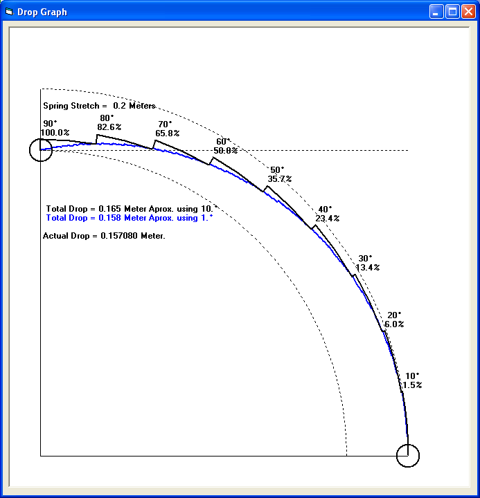

arthur,
When the tube is tilted upward 10º then the 1 kilo weight will exert 1.5% of its weight to stretch the spring. If we assume that the spring tension varies from 0 Kilogram to 1 kilogram over a distance of 0.2 meters then the 1.5% of the weight will stretch the spring 0.003 meters.
At 20º upward tilt gravity will stretch the spring 0.0120 meters
At 30º upward tilt gravity will stretch the spring 0.0268 meters
At 40º upward tilt gravity will stretch the spring 0.0468 meters
At 50º upward tilt gravity will stretch the spring 0.0714 meters
At 60º upward tilt gravity will stretch the spring 0.1000 meters
At 70º upward tilt gravity will stretch the spring 0.1316 meters
At 80º upward tilt gravity will stretch the spring 0.1652 meters
At 90º upward tilt gravity will stretch the spring the full 0.2 meters
Attached is a graph of the path of the weight in steps of 10º shown as black.
The amount of extra lift needed to stretch the spring is calculated as about 0.165 kilo/meters when using a very rough 10º step.
Also shown is a blue graph line using 1º calculation steps. It calculates out to about 0.158 kilo/meters of extra lifting.
If the steps were infinitely small then the actual extra lifting would be about 0.157080. This is equal to Pi / 4 • 0.2 kilo/meters when the weight is 1 kilo and the spring stretch is 0.2 meter.
Because the spring is not constant and has only about 1 kilo of tension when extended to 0.2 meter it will not lift the weight. But it will just hold the weight at that height until the tube starts to tilt down again.
As you can see from the graph you must lift the weight higher so that it can fall and stretch the spring.
If we were to use a constant tension spring, say with a tension of 0.826 Kilo then the weight will not even begin to stretch the spring until the tube has tilted 80º upward. This is because at 80º the 1 kilo weight mass will exert 0.826 kilo of force on the weight due to the tilt angle. Only then will the weight start to drop and stretch the spring.

ok,
good work Jim.
your graph is correct
the weight does fall slightly.
however,
as you have shown,
the weight does not fall before the arm reaches 80 degrees,
it is only lifted.
so, for simplicity,
lets just talk about the lifting from 0 - 70 degrees,
where the weight reaches 1 vertical meter.
from 0-70 degrees the weight is lifted 1 vertical meter
up the frictionless path of the blue line.
this would require the same force as rolling the weight 1 vertical meter up a hill with the same path as the blue line.
can we agree on this....??
