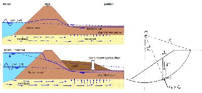

The "how" is rather difficult, I don't think they are simulatable with WM2D.
The attachment, which I found somewhere on the net, shows some interesting indications of the "how".
Like a blue line (left) showing some trickling water-level, and on the right a Fellenius slope stability analysis.
Looking at these I think one can simply conclude: They do just fine.
The only wet feet we have here is from some heavy autumn rains...
