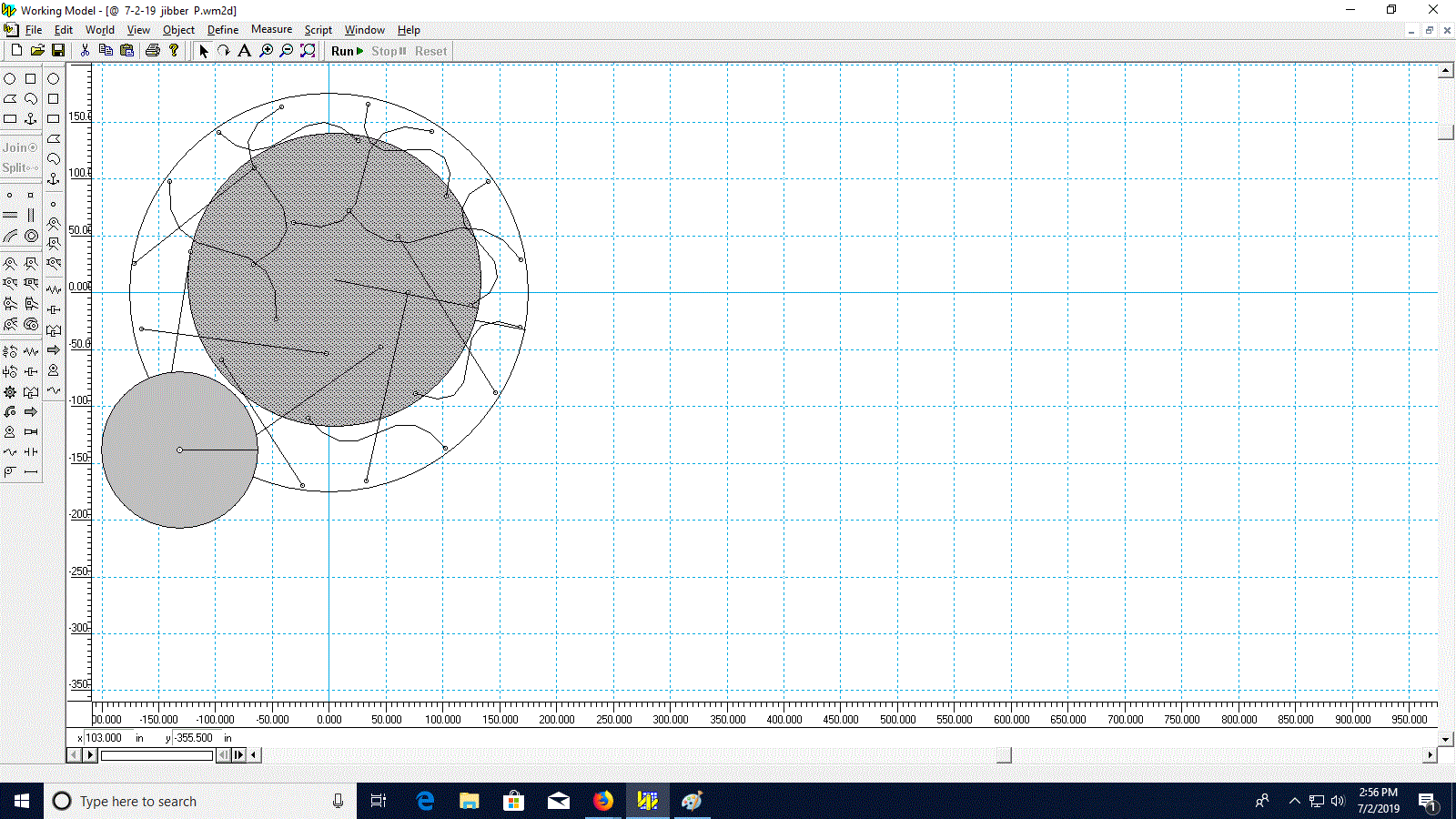

WM2D working simulation
Simulation works, but not clear if it could be built to work.
Only one weight...blue...hanging with ropes.
Trying to break symmetry... ascending uses short ropes...
descending uses longer ropes near weight center.
Friction set to zero since weight suspended with ropes
does not touch outer wheel/circular frame.
Out of desperation, uses external wheel/pusher to
nudge weight off center.
Busy and probably not going to work on this anymore.
Will check back here to answer questions.

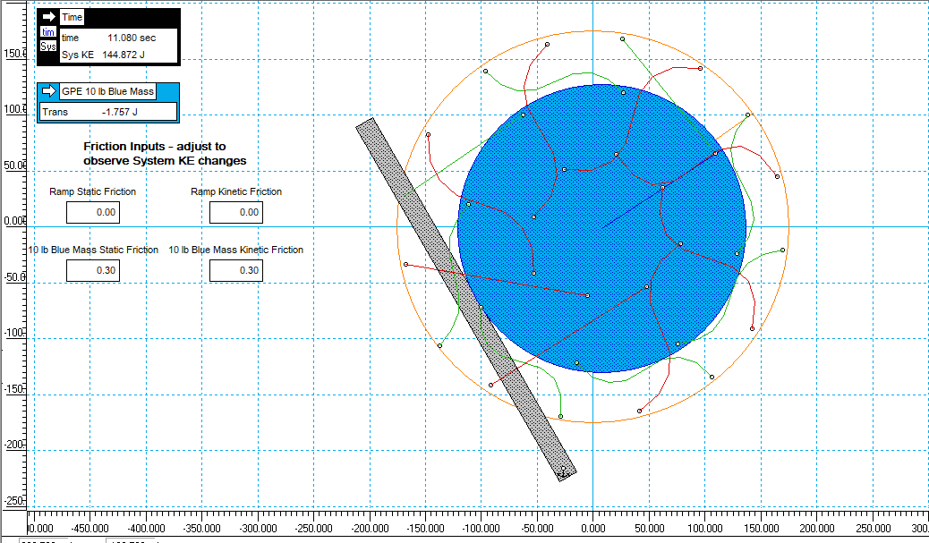

re: WM2D working simulation
The sim gains System Kinetic Energy as you'd expect. That is from the 10 lb Blue Mass initially falling and losing GPE.
This loss in GPE should be converted into equivalent amount of System Kinetic Energy Joules (BTU) with no frictional losses. That's CoE.
I have taken your sim and made some more Outputs and Inputs to change some critical things, and easily see at a glance what's happening.
The acid test is do the outputs look realistic and are changes to hardware realistic etc (like zero frictions) ?
In my adjusted sim the thing accelerates and the System KE climbs to circa 145 J's. That seems about max speed I can get. From a loss of GPE of about 5 J's (bounces a bit). Well OU from this result.
The bottom line is that having either the Ramp or the Blue Mass with zero static and/or Kinetic Friction may not be realistic from a materials standpoint. Unless you discovered a unicorn thigh bone to use.
Try using very low coefficients and see what happens to the comparison between GPE lost and KE gained; and CoE ?
amended latest to replace ramp with roller,
set all frictions to 100....should kill it but doesn;t
runs slow...but seems perpetual
- @ 7-2-19 jibber P.wm2d
- simulation
- (18.03 KiB) Downloaded 175 times

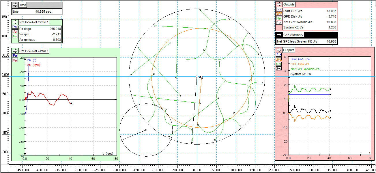

Re: re: WM2D working simulation
Hi again Bill .. hate throwing spanners in the works but here goes.Bill_Mothershead wrote:amended latest to replace ramp with roller,
I took your sim and added some outputs (plot graphs etc).
I also thought something wasn't right in those outputs and found a circular mass way down the page (circle[13]) which I deleted. That was better.
Then I enabled view system CoM by turning it on and making the yellow 10 lb disk transparent so we could see the CoM move around.
Then I had a look at your frictions set to 100.00. The range is actually 1.00 to 0.00, so I adjusted both to 0.10. Then I adjusted the elasticity to 0.95 (1.00 is a material called 'Unobtainable' - 1000 x harder than diamond). That was to reduce likelihood of overlap error at 200 frames per sec (could increase to 2,000) which can sometimes force objects to 'shoot' apart adding energy to the result and confusing things.
I suggest you zero in on the System CoM and watch it swing back and forward like a pendulum now. Sorry !
The rest of the Outputs you can take a look at for yourself. They are to do with System Energies mainly (re CoE).
You can shoot the messenger now.
ETA: I should have mentioned that if you get a result that is 'suspect' then I normally just increase the frame rate (1-2,000) so there are smaller integration steps to calculate etc. Slows things down a bit but can avoid objects overlapping and spitting things out. If still 'suspect' then I play around with elasticity for materials I might actually use.
Ultimately if it rotates but is not accelerating (as a trend) then probably it is still suspect and needs further investigation.
- ___7-2-19__jibber__pFT1.wm2d
- (23.03 KiB) Downloaded 129 times
Your skills are great Fletcher.
These smooth surfaced circular objects are actually
micro-bouncing off each other.
The simulator starts each frame by computing where each
object should be in the next frame. Then it takes a pass
to see if any objects are within each other (impossible).
The software corrects this by separating the objects.
The software error is that it is a perfect bounce.
Energy is preserved or even amplified depending on
how much the objects overlap.
This explains why it didn't work when I tried to use rods/
ropes/springs to keep the weight off center. No chance of
two objects overlapping so so never hit the recovery software.
I will keep reading this forum but I am so burned out that
I probably won't use WM2D for the rest of the year.
I hope we all learned something and perhaps somebody
gets inspired. Perhaps does a non-WM2D simulation.
