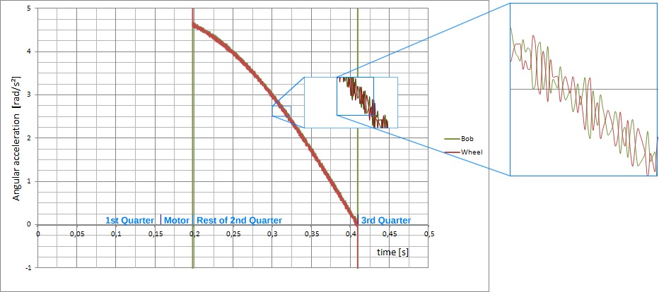

re: Decoupling Per-Cycle Momemtum Yields From RPM
mrVibrating wrote:Why not just use a rotary spring? Why not just use a radial GPE, per the MT 40 arrangement -...
Because your motor calculus is an indirect measurement; You assume it is correct, somehow it isn't.ME wrote:Temporarily, for verification purposes as it is somewhat more limited than a motor
The information you gave about the calculus seems to indicate that it should indeed give you the right values, I have no idea what happened in your calculus... but Overunity would be the last resort hypothesis.
For a conclusive answer on such hypothesis, you just have to build. Simple as that.
How can we attempt to verify a simulator with the simulator? By trying to find an equivalent function that can be measured directly.
I'm not talking about design, I talk about measurement.
I'm talking about measurements from a Kutta-Merson solver from which you conclude that it is able to produce overunity.
When you know what that solver is trying to solve, then you could figure out why it can't create overunity, or why you otherwise can't trust those values.
So to continue...
Hence I used a spring as an equivalent to a motor.
A linear one.
Because it's the simplest and the limited energy supply is very beneficial here. Proof me wrong about that solver and replenish spring potential without using motors or actuators.
That spring is also beneficial for anyone, besides you and me, who want to verify with a calculator or a simulator without the need of manual integration and then maybe only need a tiny bit of algebra.
You can always ramp-up complexity.
The spring variant is a direct measurement because you can track spring potential as you simulate; the formula's are the simplest; and spring potential is not affected by some frame of reference or whatever unforeseen stuff.
Maybe we can find out what happened to your manual integral... or figure out why/how that motor produces the values it does, .. or why it could be overunity if you want. You still need other measurements to check against.
So here's an example that mimics the start and end-condition of the motor part of the first cycle (Still: https://www.besslerwheel.com/forum/view ... 602#169602 )
These are my reference values (almost similar):
Code: Select all
Cycle E.k [Joules] w.Bob [rad/s] w.Wheel [rad/s]
0 96.1704 9.80665 9.80665 Brake
0.25 105.9673 10.29453 10.29355 Motor
0.50 147.4229 6.06448 16.06449 delta 10 rad/s
0.50 122.4228 11.06449 11.06449 (Inelastic)
1 102.8088 10.13947 10.13947 Cycle done
1.25 112.6021 10.61190 10.61092 Motor
1.50 153.7299 6.34579 16.34597 delta 10 rad/s
1.50 128.7290 11.34588 11.34588 (Inelastic)
2 109.1149 10.44581 10.44581 Cycle done
9 147.1444 12.13031 12.13031 Cycle done
9.25 156.9280 12.52758 12.52660 Motor
9.50 196.5816 8.09884 18.09895 delta 10 rad/s
9.50 171.5810 13.09889 13.09889 (Inelastic)
10 151.9671 12.32749 12.32750 Cycle done
- The flywheel (radius 1m) goes 10.294 rad/s anticlockwise;
- The green-bob has a downwards velocity of 10.294 m/s (radially also 10.294 rad/s)
- The blue spring has a spring-constant of 111 N/m;
- The blue spring has a rest-length of 0.50687 m;
- Over distance of 1.4142 m, the spring is expanded by 0.9073 m. With this we can calculate the initial spring potential;
- The total kinetic energy is 105.9664 Joules, The spring potential is 45.6915 Joules.
When the green-bob (after pi/2 rad) reaches 6-o'clock then difference in radial velocity will be 10 rad/s as designed.
- The Green-bob goes 6.0645 m/s to the right (Ek=18.3891 J);
- The flywheel goes 16.0645 rad/s CCW (Ek=129.0341 J)
- The Increase in kinetic energy is 41.4568 Joules;
- Because the flywheel rotated 4.2006 rad = 2.6298 rad+pi/2, the spring is stretched by 0.5033 m
- Thus the current spring potential is 14.06 Joule, so it lost 31.6315 Joule;
- The Green bob lost 9.80665 Joules in Gravitational Potential Energy,
- The sum amount of lost potential energy, equals the sum amount of kinetic energy;
Unfortunately, the system is very sensitive to used accuracy. For a ten times higher simulation accuracy I found that a spring rest-length of 0.50674 m was needed to get this 10rad/s difference. The values should still balance and close to reference.
Anyway, the initial begin- and end-speed of the Green-bob is now much closer to your result for the first cycle during the 9:00 till 6:00 action, and so is the flywheel. As the velocities dictate the resulting amount of total kinetic energy,, so does this amount of energy match,
Besides the method of making this 10rad/s difference happen, the only difference we actually have is the amount of work we calculate;
In my case the diminished spring potential matches the kinetic energy increase exactly!
You have an overunity motor for some reason... what's the explanation?
Agor rightfully mentioned the Bob's Moment of Inertia.Its axial MoI is intentionally left out of the equation; its orbital MoI is fucking paramount,
I explained that it was left out, and how he could see that it was left out. Its "fucking" orbit was not mentioned by Agor, as that's indeed obviously paramount for that idea.
Sorry that I'm not making it easy for you.

Agreed.mrVibrating wrote:This is gonna be nuts..
Oh. why don't you just say you don't understand.mrVibrating wrote:PE and KE must have different reference frames.
Ehm nope, sorry.mrVibrating wrote: Data acquired with bob at BDC, one frame prior to brake activation:
initial KE = 96.1704 J
net KE = 147.4260 J
KE rise = 51.2556 J
T*a = 26.3616
GPE out = (G * 1 kg * 2 m) = 19.6133
26.3616 + 19.6133 = 45.9749 J
51.2556 J - 45.9749 J = 5.2807 J of 'free' energy is right there, ready to perform useful work
Your KE rise is 51.2556 Joules
Part comes from the green bob pendulum that drops its GPE (19.6133 J).
This may increase stuff temporarily for this first half cycle, but it's also needed to bring it back up again for the second half cycle.
So you're left with 51.2556-19.6133 = 31.6423 Joules that comes from the motor that creates the 10rad/s difference.
Than with the inelastic clash it loses: 25 Joules.
- A hint (for others):
E.start= ½I·(ω-5)²+½I·(ω+5)²
Momentum clash and conservation I·(ω-5) + I·(ω+5) := (I+I)·(ω+5+w-5)
E.end = ½I·(ω)²+½I·(ω)²
Difference: 2·½·5²
Ready to perform an increase in angular velocity per cycle.
Marchello E.

WTF are you moaning about now? You've quoted a line from a response to Eccentrically1 where i'm pointing out that the earth must've been accelerated by gravity, since PE and KE obviously have different FoR's - ie. the latter's velocity component has been accelerated, which is why there's energy gain.Oh. why don't you just say you don't understand.
It's obviously you who cannot understand, and you're being typically snidey and disingenuous about it, besides which i simply don't have the time to argue with you - i literally have a couple of hours a day for this, anything more is encroaching on sleep time, and i get fuck-all as it is..
This is not 'collaboration'. We're not collaborating, here. Especially not with this attitude.
It's friggin' T*a, verified against the integral of T*w*t over time, and then further verified against the velocity and KE rises; 1 rad/s on 1 kg-m² costs ½ J, but 1 rad/s relative between two 1 kg-m² MoI's only needs accelerate each to ½ rad/s in opposite directions; at half the velocity each, they have a quarter the KE, and input cost. Likewise, if you meter the KE's of each part individually (so take the KE of the wheel, then subtract that from kinetic() to get that of the bob + hub), you see that the evolving KE distribution is proportionate to twice the sqrt of the velocity divergence caused by the gravitationally-accelerated T*a workload - hence the 0.33 J (or whatever for a given example) is correct, and the KE gain is being caused by gravitational acceleration of the motor's reference frame.Because your motor calculus is an indirect measurement; You assume it is correct, somehow it isn't.
With basic physics; L=Iw and KE=½Iw². There is no anomaly, outside of your head.How can we attempt to verify a simulator with the simulator?
Yes.Agor rightfully mentioned the Bob's Moment of Inertia.
No, you slapped him down with your usual BS in your usual style, but he was right and you were wrong, because you still cannot grasp the relationship between CoM and CoE, even after all these years of having it tirelessly repeated for you.I explained that it was left out, and how he could see that it was left out. Its "fucking" orbit was not mentioned by Agor, as that's indeed obviously paramount for that idea.
The principle interaction is between two equal MoI's, one of which is also subject to gravity. The bob's axial axis is obviously unused - its active MoI is orbital, per mr².
Sorry this has already taken up more time than i have available.
Typical ME mindset. If only you'd play the ball, not the man..Sorry that I'm not making it easy for you.
The target's CoE, not me. This blue-on-blue BS is just wasting good ammo..

I hope I can write down what happens in the simulator.
The motor does not need the whole quarter to create the 10rad/s separation.
It indeed invests about 25.6 Joules for the 10rad/s separation for about one third of the height of the bottom quarter (after about 18.9° engagement).
After that, the motor locks itself to the pendulum?
The rest of the pendulum potential (about 0.676 m--> 6.63 J in GPE) is used to accelerate them both.
So according to the available data it so seems that mrV is correct in his conclusion.
... When we assume that this data is indeed correct.
To lock this system in sub-microseconds the wheel has to change the acceleration from 154.6 rad/s² till ... (data says 0 rad/s²)
According to measurement the pendulum goes from a -145.46 rad/s² (deceleration) to +9.295 rad/s acceleration (according to the data).
When we track the velocities of the pendulum bob and the flywheel and calculate both their dω/dt to get us their real angular acceleration, then we see that the acceleration is almost split between the two.
The question is, are the wheel and the bob a coupled pair or not after reaching that 10rad/s separation?
Attached shows the calculated dω/dt and the struggle of WM2D to split that difference because the wheel acceleration and motor-torque is set to a solid zero.
When it would not be coupled, then the wheel (with a disengaged motor, and disengaged brake) would freewheel with the same velocity it had at the moment the motor disengaged (15,49 rad/s).
But the wheel can't be coupled either, because that would mean that they would have the same velocity, yet the pendulum goes with 5.49 rad/s at motor disengagement.
We can test that effect by calculating the uncoupled situation where the pendulum bob has that position (270°+18.9°) and given velocity, and let it drop till reaching BDC.
The amount of total kinetic energy should just increase with that mentioned 6.629 Joule GPE it has from the height of the pendulum bob and reaching an end-velocity of about 6.59 rad/s (request a write out), instead of the 6.06 rad/s.
Because it didn't accelerate the flywheel it falls short in energy. It is some reversed effect as happens with the inelastic collision, but apparently only valid within the simulator.
It is a mystery how how in reality to split the acceleration while having a speed differential.
Any locking attempt (string, spring, damper, magnet) would engage an early momentum-clash, and would thus drain energy instead of increasing it.
Summary:
The simulator keeps the motor in a tight-enough lock with the pendulum and somehow splits the gravitational force that acts on the pendulum alone.
As a result only the pendulum should accelerate, yet the motor keeps it tight: it should invest energy in order to apply a force to keep the pendulum close from otherwise getting ahead;
Yet the implied acceleration is not registered as an effort of the motor, but it is still doing it.
Maybe it is programming that's applied to this torque that overrides the values and messes things up.
Anyway, mrV, your data is insufficient.
