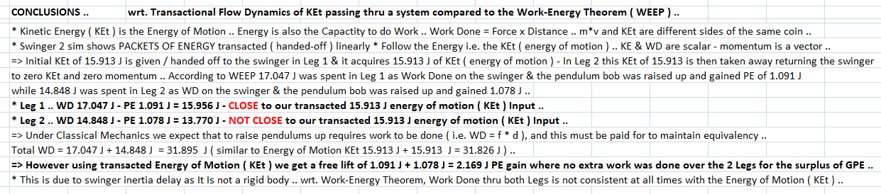

Below is a Results Summary Table I decided to make of the 3 sims comparison experiments ..
I give my "Conclusions" below the table ..
I'd be interested to see if after having studied the numbers anyone draws different conclusions to me ( probably ) .. always willing to consider a different point of view because you may have a better argument than me Gregory, or more accurate insight ..
P.S. Momentum and Kinetic Energy are different faces of the same coin - I used Impulse transfer in the sims because it assumes a 100% transfer of momentum - and that m*v has KEt - I could have just used KEt - but I used m*v transfer because a runner needs to have its energy source explained - and m*v can come from the connection to the earth as I theorized previously ..
Not Loading .. will add as an attachment ..

CONCLUSIONS .. wrt. Transactional Flow Dynamics of KEt passing thru a system compared to the Work-Energy Theorem ( WEEP ) ..
* Kinetic Energy ( KEt ) is the Energy of Motion .. Energy is also the Capacity to do Work .. Work Done = Force x Distance .. m*v and KEt are different sides of the same coin ..
* Swinger 2 sim shows PACKETS OF ENERGY transacted ( handed-off ) linearly * Follow the Energy i.e. the KEt ( energy of motion ) .. KE & WD are scalar - momentum is a vector ..
=> Initial KEt of 15.913 J is given / handed off to the swinger in Leg 1 & it acquires 15.913 J of KEt ( energy of motion ) - In Leg 2 this KEt of 15.913 is then taken away returning the swinger to zero KEt and zero momentum .. According to WEEP 17.047 J was spent in Leg 1 as Work Done on the swinger & the pendulum bob was raised up and gained PE of 1.091 J while 14.848 J was spent in Leg 2 as WD on the swinger & the pendulum bob was raised up and gained 1.078 J .
* Leg 1 .. WD 17.047 J - PE 1.091 J = 15.956 J - CLOSE to our transacted 15.913 J energy of motion ( KEt ) Input ..
* Leg 2 .. WD 14.848 J - PE 1.078 J = 13.770 J - NOT CLOSE to our transacted 15.913 J energy of motion ( KEt ) Input ..
=> Under Classical Mechanics we expect that to raise pendulums up requires work to be done ( i.e. WD = f * d ), and this must be paid for to maintain equivalency ..
Total WD = 17.047 J + 14.848 J = 31.895 J ( similar to Energy of Motion KEt 15.913 J + 15.913 J = 31.826 J ) ..
'=> However using transacted Energy of Motion ( KEt ) we get a free lift of 1.091 J + 1.078 J = 2.169 J PE gain where no extra work was done over the 2 Legs for the surplus of GPE ..
* This is due to swinger inertia delay as It Is not a rigid body .. wrt. Work-Energy Theorem, Work Done thru both Legs is not consistent at all times with the Energy of Motion ( KEt ) ..

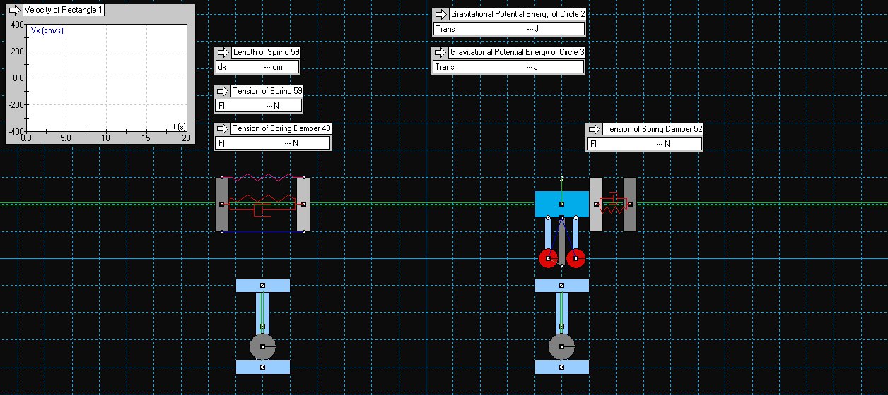

Ok, in this experiment I used a cart with two swingers, plus two spring terminals to start and stop the cart.
The cart is started by a compressed spring, and later stopped by another identical spring, and in the process both swingers rise up reacting to the acceleration/deceleration, same as before.
The twist is that at the second terminal I added an additional violet color spring which is enchanted with the amount of energy as the collected GPE. So, the cart will be also accelerated backward to its starting position by this additional spring force. If there is a gain the first spring should become compressed somewhat more compared to the starting condition. But unfortunately, it doesn't happen.
I tried to make this work as a continuous loop, so we can watch the cart go back and forth dozens of times. However there is a catch, the violet spring's formula contains a constant which I couldn't represent with a variable so far, and for that reason it won't be accurate after the first 1-2 cycle.
Basically, that's all. It was quite a challenge to tame wm2d to make this work. Perhaps still could be improved.
