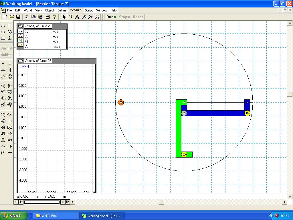

Ok here is the best I can do with the WM2D version.
It is very similar to the Algodoo one you have Fletcher except I increased the weight of the blue beams and counter weight.
I had to set the accuracy very high to get it working better and this only worked for one impact before it ran out of memory.
However it did appear to increase speed on that impact.
I still don't know what to make of it but hopefully you can get some answers Fletcher.

Hello Roxaway59
You can lower the setting and note what happens.
The contact movement fix methods should show up.
Some integration errors are fixed post calculation by repositioning the moving objects on the quite.
With no other variables being changed. Another is to add a reflection of the momentum vector with an energy loss factor.
Or have an exponential repulse force. That really blows things up.
You can see this better in lower setting and deduce what has be implemented.
With the Geometric Algebra it is trivial to find contact & intersection points.
So the place where the object makes contact and it's momentum is reversed[mirrored] is not loose.
Note. You can get allot by finding how programs fail.
Thanks agor95 I will try to delve deeper into WM2D to see if I can work some of these things out. I only use it in a basic way but that obviously doesn't help when I need to analyse something.
Are you saying that the way something appears where objects meet is misleading?

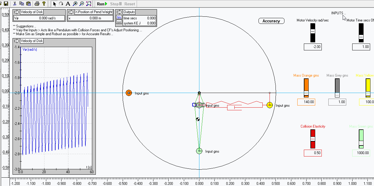

Hi again Graham .. I took your WM version ( which I can interrogate ) and made some changes that I think add to general understanding of the sim for all, and the "trends" you were experiencing ..Roxaway59 wrote:Fletcher I do hope that you find something positive about these simulations but I have to say that at the moment I'm not convinced.
The more I experiment with them the more I find things that don't make sense to me and these types of things are typical of the kind of bugs that seem to be in Algodoo.
I'm seriously considering getting a real wheel that I can experiment with rather than using the simulators. I'm starting to think its a much better way forward.
I first swapped out the part parallel rectangular sections for rods and a spring dampener for the horizontal - all "elements" in WM are massless which takes some of the fuss out of a sim in WM - the spring dampener element was added instead of a rectangle or rod so that it had some "flex" in it, otherwise after a turn or two it would bind, lockup, or explode thru the "squeezing" thru the eye of a needle effect ( as I coin it ) - then I decided to change out your polygon built AH for a simple hanging equivalent - and added more outputs for analysis purposes and inputs for everything of importance imo ..
The hope is to make it more simple to understand for us and non-sim users, and generic in nature, decluttering it down to basics, and focusing on the actions of importance as I see them ..
Now we can see at a glance that it is indeed just a pendulum analogue that collides with a heavy hanging AH - the motor starts it turning at a steady clip then is turned off after 1 second - n.b. I have graphed the disk velocity and you can see the trends as it loses rpm thru dissipative collision energy losses ( as we might reasonably expect I think ) - we can also see it swing out the light "hammer ( grey )" on the down-going side due to Cf's ( inertia ) of the connected to yellow mass attempting to follow a straight line path ( Newton's Laws ) ..
Have a play around with the various inputs and re-run the sim etc after your changes - n.b. it is now stable thru all ranges of inputs and accuracy settings ( set to 200 fps but works well at all accuracies low and high IINM ) - see if the graphed out rpm trends for the disk change ( increase ) in your favour ( i.e. indicative of kinetic energy accumulating ) etc as you thought might be feasible before I did my restructuring of the sim ..
Sim attached ..

Hi Fletcher thanks for taking the time once again.
I understand why you simplify the build. I hope you can see why I tried to keep the build as realistic as I can. I do know that in the real world these things don't lock up as easily and it could be as you say because things are looser in the real world.
It's time for me to marry these experiments with the real world because I feel that the unrealistic nature of Algodoo and to a certain degree WM2D is not working for me on its own.
Should be a fairly simple build Graham .. I've done my fair share of real-world builds when either WM frustrated me or I had some doubt about what it was predicting - a real-world build is the ultimate simulator afterall - skills in each improve the other - I look forward to hearing what your real build shows you ..
