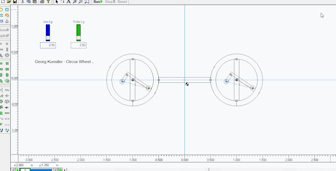

Hi Georg .. here is a close up of one side of your circus-wheel configuration ..
I have drawn in a red line and a blue line to show you some things ..
Since the arm weight and the roller weight are the same mass then the mid point of the blue line indicates where their combined COM would be ( relative to the sub-axle ) ..
The red line shows the connection from the center of the sub-axle to the center of the roller-weight - this is a constant length and does not change - the roller-weight is in contact ( static friction ) with the ring but cannot roll around it because the effective radius does not change at any time - iow's there is not a path of least resistance for it to escape to .. i.e. it can not roll around the rim, and there is no advantage to having the L lever pinned above the sub-axle imo ..
Given that the radius does not change I have rebuilt the sim with the sub-axle pivoted to the mid-width point of the L lever as the second pic shows ..
Will come back with animations of the sims running soon ..

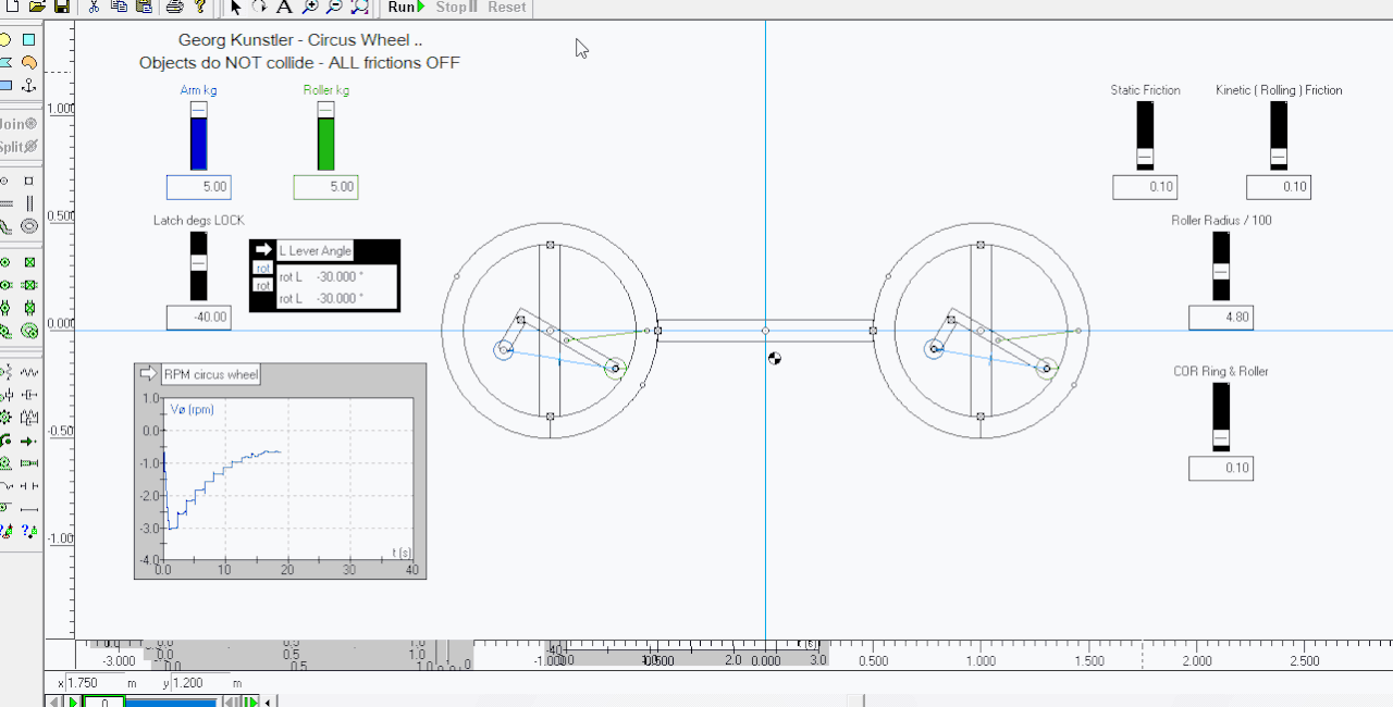

Here is the first sim animation of what wm2d predicts will happen in your circus-wheel Georg ..
Re: the gravitational energy converter
Here is what wm2d predicts will happen with the direct mid-width L lever pivot position that also doesn't change radius length etc ..

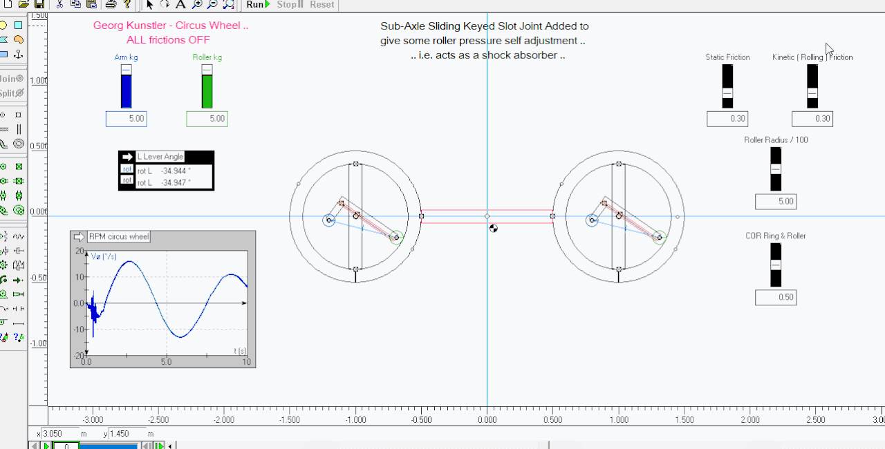

To wrap this up, unless Georg has a video to show to prove his assertions that the L-levers keep climbing back up to 4 o'cl in his circus wheel .. in which case I will revisit it if able to ..
This is about as good as I can do in wm2d - it's accurate as far as I can tell or anticipate ..
** I have added a "Sliding" Keyed Slot element to his L-levers where they right angle connect to the sub-axles ( as per his original instructions to have offset L-levers ) - this allows the rollers to turn on the ring inner rim i.e. it gives the assemblies some "give" acting like a self adjusting shock absorber - this stops them binding up with friction contact ( even when frictions is small ) ..
** Sim attached .. have a play .. improve it ..
** Note that the rollers now roll, and the system COM / COG torque turns the circus wheel - then it swings back the opposite direction - the rpm fluctuates between positive and negative until the rpm oscillations die down and it comes to a stop ( energy lost to Elasticity / COR dissipative losses ) - the important part is that the L-levers do not climb back up the ring as is said to happen - the whole assembly moves rather than the L-levers constantly rolling up the ring trying to find 4 o'cl .. imo ..

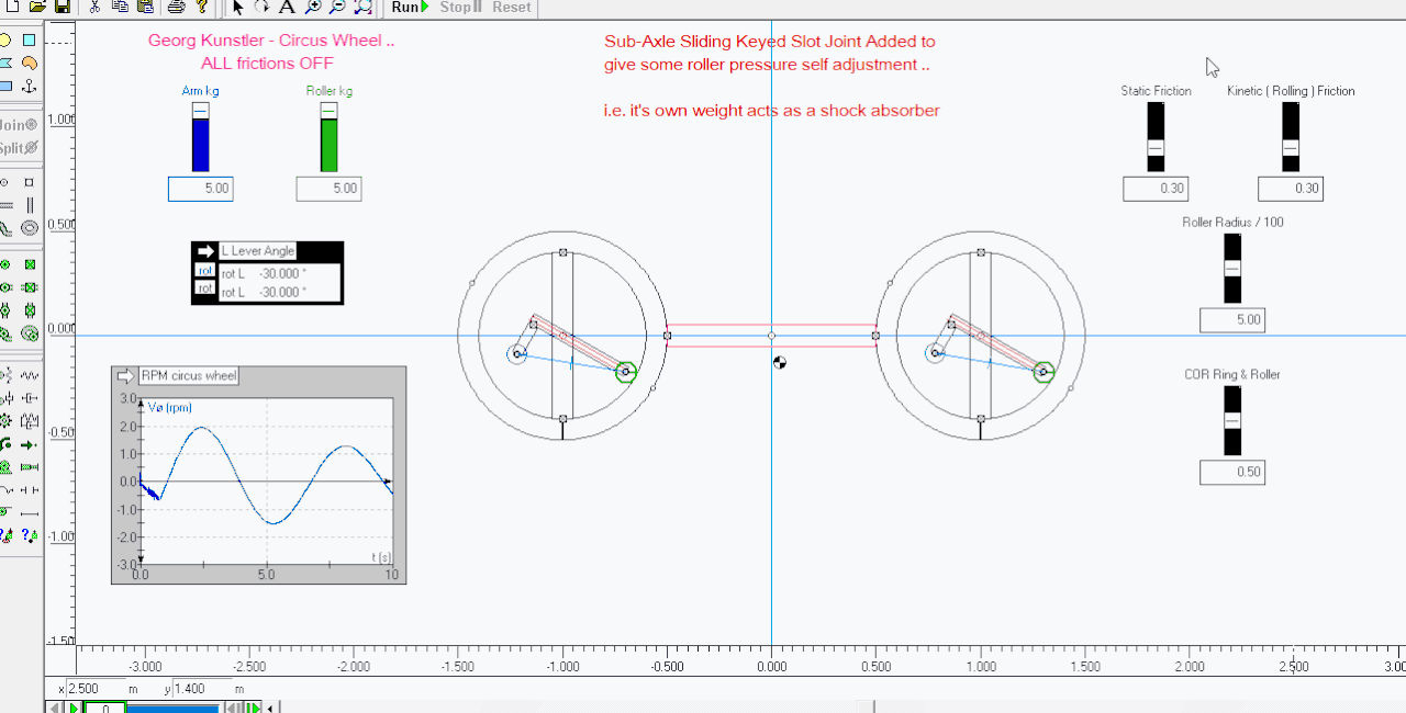

Should have put this up yesterday ..
It is the direct comparison to yesterdays sim - also with a sliding slot but located mid width of the L-lever ..
The sim predicts both behave for all intents and purposes in identical ways as can be seen in the animation below - the L-levers roll down the ring losing Net GPE and shifting the system COM / COG - the relocated system COM causes a torque on the wheel - the L-levers do not climb back up the ring and the wheel finds its position of least PE ( balance position ) ..
.. sim attached ..
