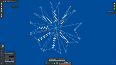

This is as far as I could get but the thing just twitches randomly after I attached circles to one of the levers.
It should remain open on the right side and close on the left but it's twitching randomly and not obeying any laws of physics. I think this is the real Bessler's Wheel that we are all looking for here."It's not the size of the dog in the fight, it's the size of the fight in the dog." - Mark Twain

I just opened the picture attachment and noticed a few things.
The center circle isn't 'centered' (assuming the axle fulcrum is at the center of rotation). It appears offset, and to which the pivots and springs are attached etc.
Secondly, on closer inspection of the pivot joint connection points appear to not all be the same relative position i.e. it seems from the pic that they are not accurately placed, and the same for each mech set.
If so this puts different 'stresses' (leverage characteristics) on the parts that interact and they may not behave as you would expect as the sim begins to calculate.
Bottom line - scale and accuracy is important in the design and the sim build phase. Also try upping the sim iteration accuracy and then back it off when it behaves correctly. It may be overlap error 'spitting' parts apart. Check for non collision as RH talked about earlier.

hmmm .. I assume you can alter the number of frames per second Algodoo calculates at ? The higher the better usually (especially if there are overlap errors spitting objects apart i.e. objects mysteriously move apart (if set to collide/contact and overlap) and have residual velocity and energy because of this (it's not proof of free-energy, just the program trying to be accurate))). But it will slow the sim down as it has so much to calculate from frame to frame.
