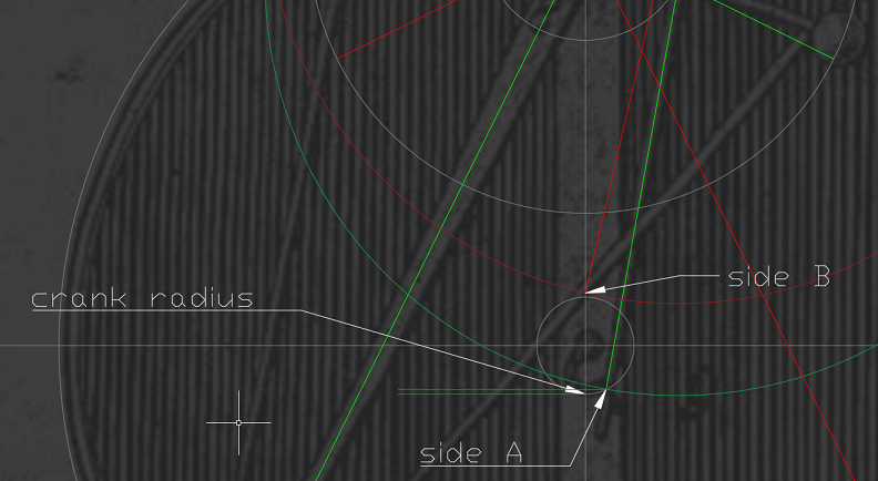

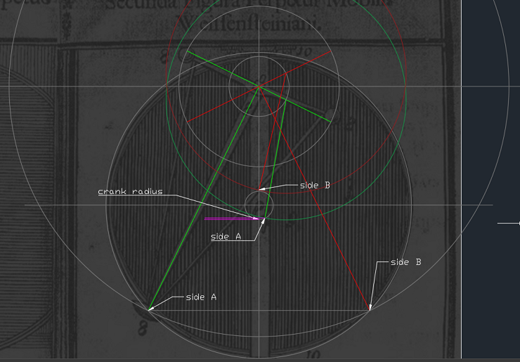

In this example drawing , the pendulum would rock/swing from side A to side B , and while the rod linkage between the crank and the pendulum must remain at the same length , while also having the pendulum reach its starting and ending positions on the crank through the rod linkage on the crank at the top maximum radius and bottom maximum radius of the crank , as drawn , cannot happen if you just randomly draw them in without mathematically/mechanically designing them for real , to start and end more or less at the same angle/heights.

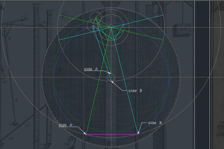

Here is a closer look showing a small height/angle difference created from the center vertical line, the difference was kept to a bare minimum which leads me to believe there was actual math/mechanical design behind them.
In this drawing i made side A and side B start and end at the same angle/heights from the center vertical line , but as will be seen on the next drawing , the actual start and end angles/heights would be slightly different when the rod would run along the crank radius , but again this difference is kept at a minimum due to the locations and lengths and angles on the illustrations , which must be due to real mathematical or perhaps real mechanical design.
If you do not design the linkage to the crank and the pendulum correct , the difference for start and end angles and consequently height , for a full swing could possibly be much larger in error .
ETA: A clarification , by saying "If you do not design the linkage to the crank and the pendulum correct , the difference for start and end angles and consequently height , for a full swing could possibly be much larger in error ." :
I mean to say , at the start of a swing the height could be different from the height at the end of a swing ,that being higher or lower than the other side of the period , which is unwanted for a swing driven by a rotating crank .

For example marking the animation you provided:
Last edited by johannesbender on Thu Jul 04, 2024 8:29 pm, edited 1 time in total.

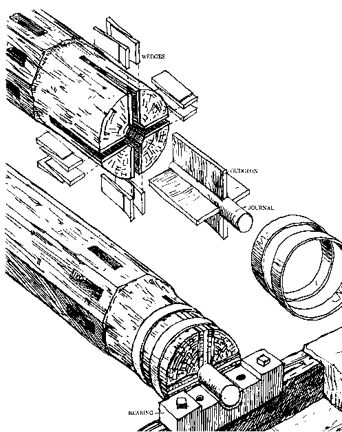

10. The cranks themselves, or pivots, screwed into the axle,
Posts: 772
Re: Were the pendulums real ?
Type d'assemblage en meunerie!
Type of assembly in milling!
